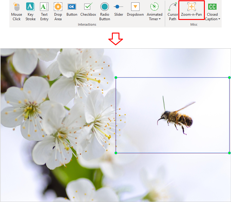

Step 1: Insert a zoom-n-pan object by clicking Zoom-n-Pan in the Insert tab.
Then, you will see the zoom-n-pan rectangle appear on the Canvas with four green handles.

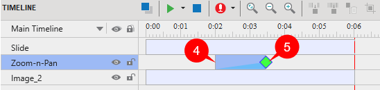

The zoom effect will start to zoom in at the starting point of the object (4) and end at the green diamond (5). The light blue area inside the object Time Bar indicates the effect timing.
To change the start time of the zoom effect, do one of the following:
- Select the zoom effect object time bar on the Timeline pane > the mouse turns to a four-way arrow > drag it to the left or right. Besides, you can drag the starting point (4) to change the effect start time. However, using this way will change the effect duration at the same time.
