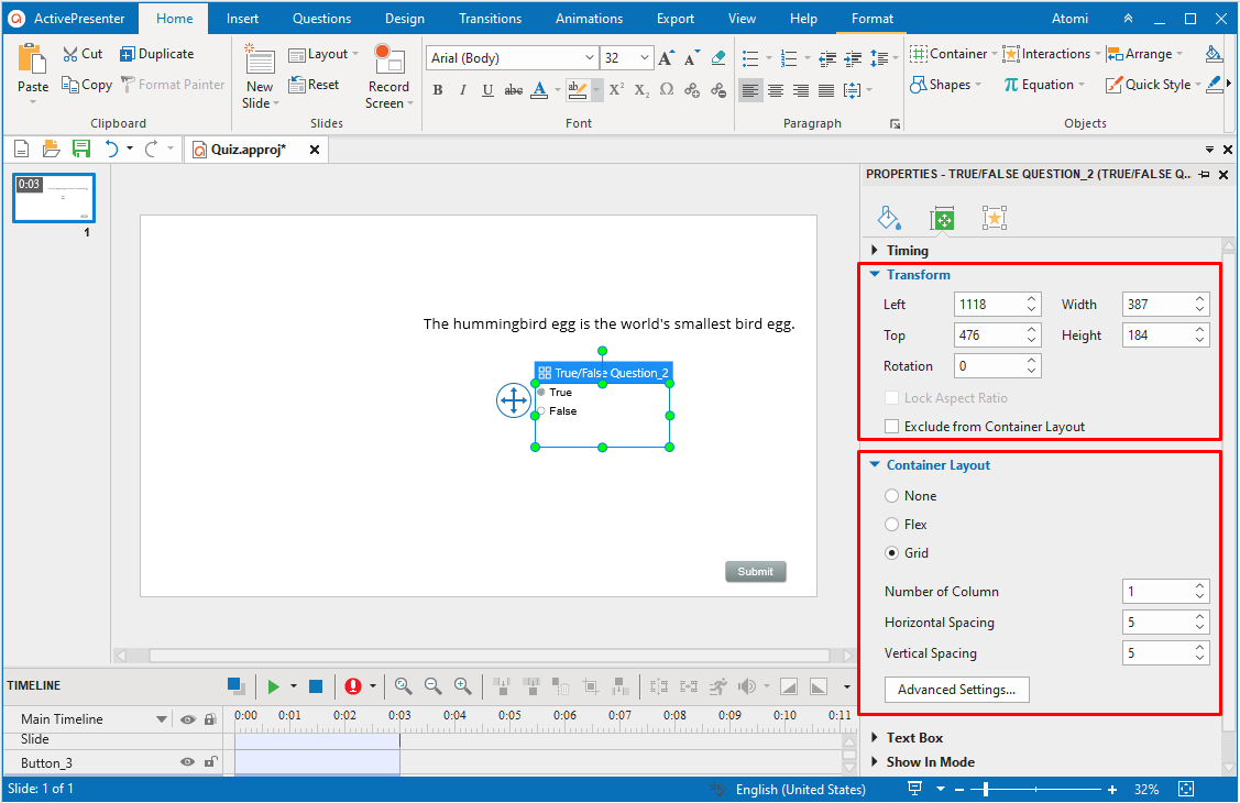

2. Resize and Rearrange the Question Position
- Resize the question title (1) and the answer area (2): You can resize these sections by selecting them and dragging the resizing handles. Or select them, then go to the Properties pane > Size & Properties tab > Transform to adjust or type the value in the Width and Height combo box.
- Change the container layout: By default, a question is set in the container layout. To change the question container layouts, select the answer area and access the Properties pane > Size & Properties tab > Container Layout. In this section, ActivePresenter 9 offers you three options: None, Flex, or Grid. Select the layout mode that you want. Then, you can customize its properties.
- Rearrange the question position: On the Canvas, drag the question to a new position. Or, specify the values in the Transform section in the Size & Properties tab of its Properties pane.

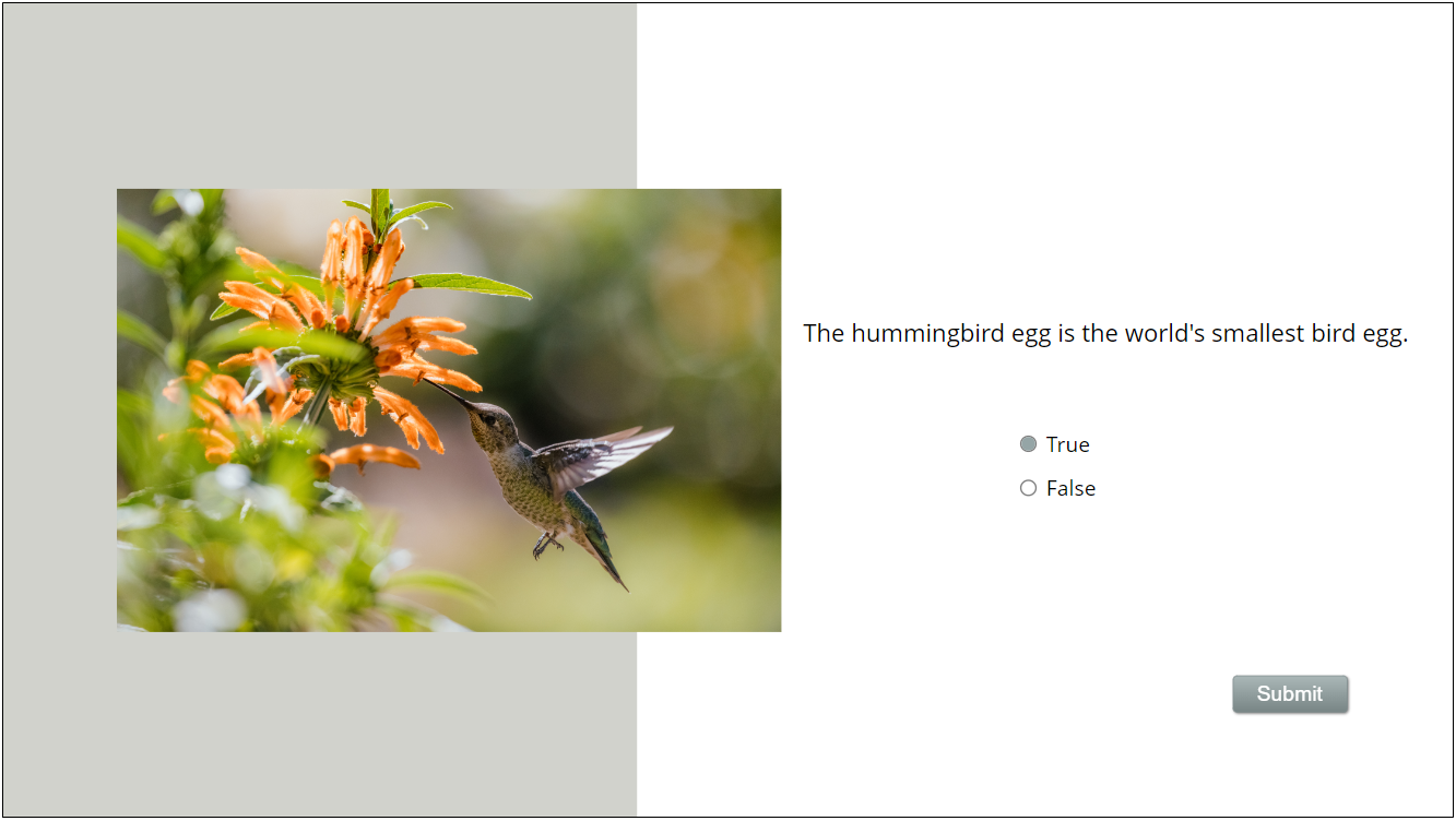

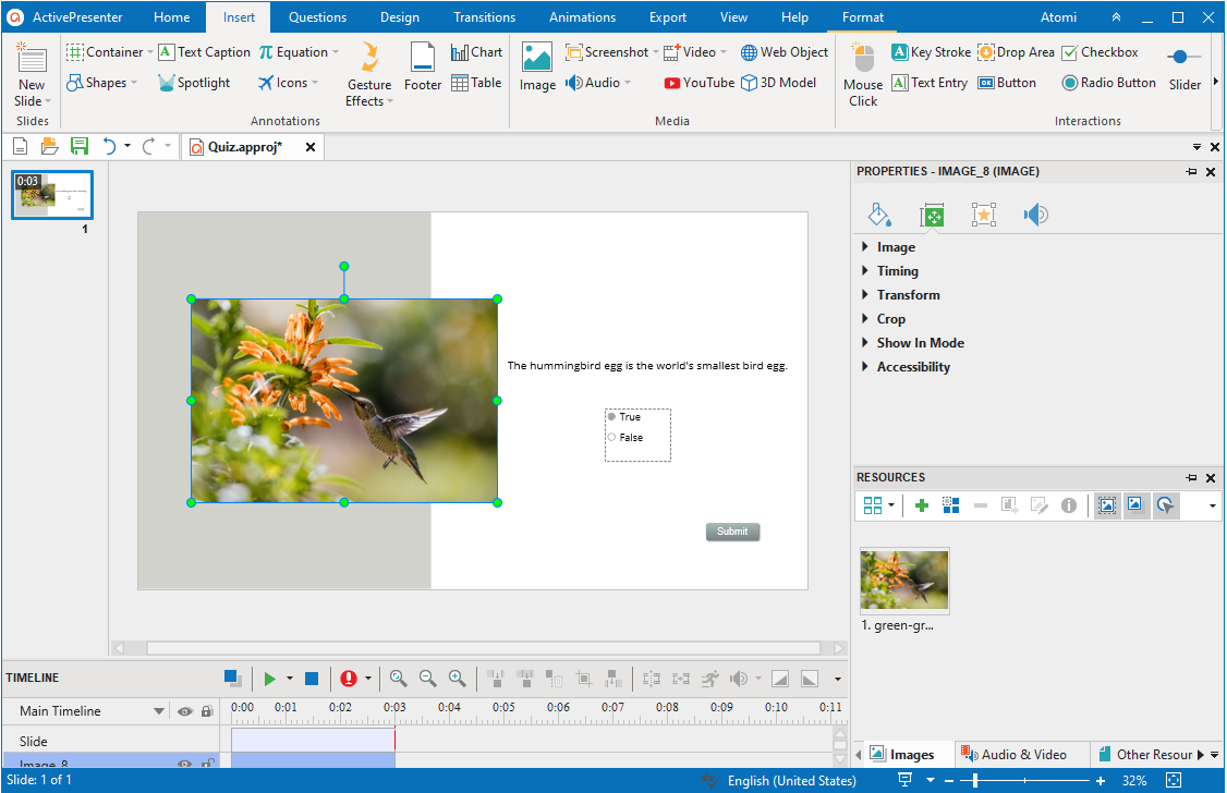

3. Complement with Shapes, Images, Videos, or Audio
You can freely add resources such as shapes, images, videos, audio, and more to your question by accessing the Insert tab, or simply dragging and dropping them from your computer to Canvas.

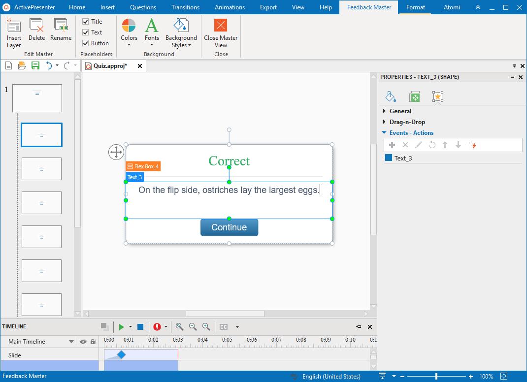

5. Modify Feedback Layers
ActivePresenter automatically adds default feedback layers for a True or False question. To open them, in the View tab, select Feedback Master. Then modify them as you wish.
The default feedback layers can be Correct Feedback, Incorrect Feedback, Try Again Feedback, Incomplete Feedback, and Timeout Feedback (for the Graded mode) or Complete Feedback, Incomplete Feedback, and Timeout Feedback (for the Survey mode). Note that you can delete, change, or add more if necessary.
