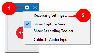

Open Recording Settings Dialog
In the Record Software Simulation Project dialog, click the Settings icon (1) at the top-right corner, then select Recording Settings… (2) from the pop-up menu.
open dialog box
After that, the Recording Settings for Software Simulation dialog will pop up having four tabs: Audio & Video, Cursor, Annotation, and Hotkeys.

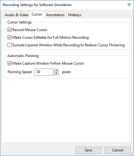

Cursor Tab
Cursor tab
The Cursor tab allows you to have settings for the cursor in recorded videos.
Cursor Settings
  • Record Mouse Cursor: ActivePresenter will record mouse cursor for your record videos that makes it easier for the audience to follow your steps. Otherwise, your video will have no mouse cursor recorded.
  • Make Cursor Editable in Full Motion Recording: If this checkbox is selected, you will be able to edit the cursor properties such as cursor highlight, mouse click sounds and effects in your recorded video.
  • Exclude Layered Window While Recording to Reduce Cursor Flickering: When recording videos or creating software simulations, some layered windows may appear on the screen. In that case, ActivePresenter will exclude those windows that you don’t want to record.
Automatic Panning
Automatic Panning is used if the blue rectangle is smaller than the recorded application screen. Plus, if you want to freely move the blue rectangle to any part of the screen while recording, this feature is right for you.
  • Make Capture Window Follow Mouse Cursor: Whenever you move the mouse on the screen, the blue rectangle will follow it.
It’s useful especially if your target recorded application has many controls.
  • Panning Speed: The speed that the blue rectangle will follow your mouse movement.

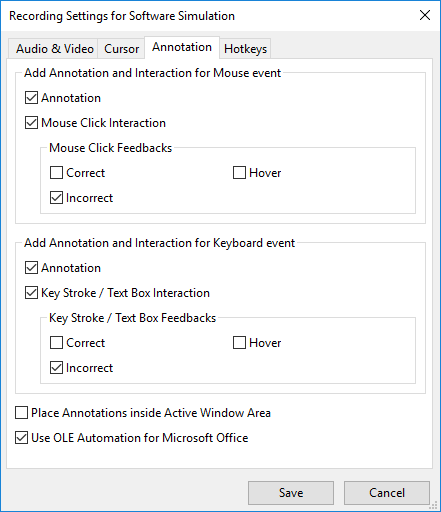

Annotation Tab
Annotation tab
This tab gives you controls of annotations and interactions for the mouse and keyboard that are automatically added during recording software simulations.
Remember that the Annotation tab is only activated when you are recording software simulations. Recording video demos function doesn’t have this tab.
  • Annotation: Select these check boxes if you want to add annotations as hints or feedbacks to guide learners.
When recording software simulations, this option should be selected. Annotations can be shapes with text inside that tell learners how to behave in a specific step.
  • Mouse Click Interaction and Key Stroke/Text Box Interaction: Select these check boxes if you want to provide feedback messages corresponding to user actions (Correct, Incorrect, and Hover).
This feature is very useful especially in creating software simulations. For example, you can let the simulation show correct messages when users take correct actions. On the other hand, Incorrect messages can let learner know that they have done a wrong action.
  • Place Annotation inside Active Window Area: Let you place all the annotations that are automatically added during the capture inside the Active Window area.
When recording videos or simulations, you may want to capture only a specific window sometimes (e.g. confirmation dialog). ActivePresenter can automatically detect that area and save the information to captured slides through the Active Window feature.
This option is important especially when you chose to view or export the Active Window area only.
  • Use OLE Automation for Microsoft Office:
ActivePresenter can get a more precise size and location of captured interactions when you record MS Office. But sometimes it causes MS Office working improperly (for example, MS Excel 3D references). If this happens, just deselect this check box.
For capturing other applications, you can ignore this option.

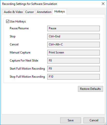

Hotkeys Tab

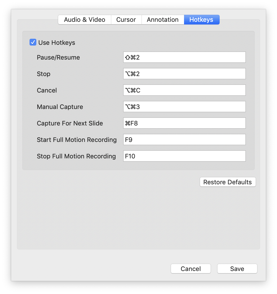

The Hotkeys tab allows you to set the shortcuts for some of the most usually used functions such as Pause/Resume, Stop, etc. Note that because of the differences between MacOS and Windows keyboards, the Hotkeys tab in ActivePresenter will look differently on these devices . Please see below images:
Hotkeys tabThe Hotkeys tab in Windows
Hotkeys tab in MacThe Hotkeys tab in MacOS
Remember to select the Use Hotkeys check box to activate all of its properties below. Then click any command box and press a key or a combination of keys to assign new hotkeys.
Note: In ActivePresenter, you can also customize hotkeys for many other commands such as Cut, Copy, Delete, etc. To know more about how to do that, refer to Customizing Hotkeys.
After all the changes, you can still go back to default values by clicking the Restore Defaults button.
Finally, click Save to save all the customizations you have in each tab and close the dialog.
