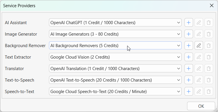

- Go to the AI tab at the top of the interface.
- Click on Service Providers to select a Background Remover provider.
- A window will pop up where you can manage your providers.

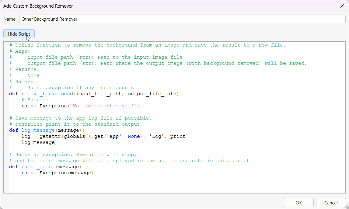

- Click
to Add Custom Background Remover. Then, select Other Background Remover, the Add Custom Background Remover dialog appears, allowing you to change the custom background remover’s Name, Edit Script/Hide Script. Click OK to save all the changes. Click Cancel to cancel the settings and close the dialog.
- Click
to Edit Custom Background Remover. Then, the Edit Custom Background Remover dialog appears, allowing you to change the custom background remover’s Name, Edit Script/Hide Script. Click OK to save all the changes. Click Cancel to cancel the settings and close the dialog.
- Click
to Remove Custom Background Remover.
Tip: In case you do not need to add a custom provider and just want to use the default provider that ActivePresenter offers, you can skip this step.

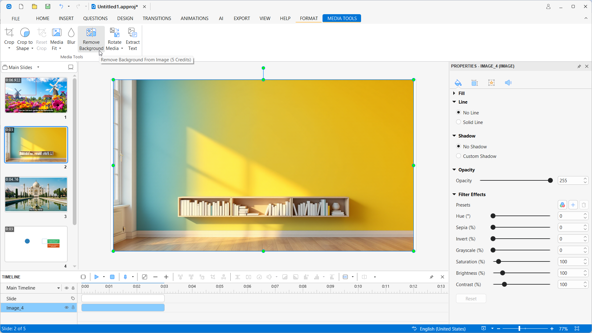

Step 3: Instantly Remove the Background
This is the fastest part of the process!
- Click at the image you want to edit.
- Next, navigate to the Media Tools tab in the main ribbon.

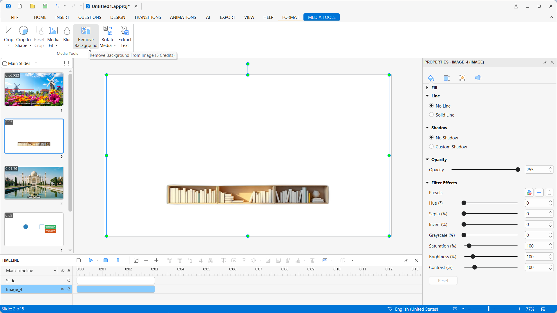

- Find the Remove Background
button and click it. The image background will be removed quickly.
ActivePresenter’s AI will automatically detect the subject and remove the background, leaving you with a clean, transparent image. You can now place this image on top of other images, shapes, or a new slide background.
