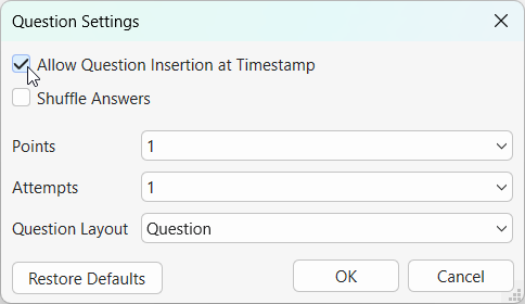

To be able to insert an interactive question in a video at a specific timestamp, you will need to enable the Allow Question Insertion at Timestamp option first.
- After launching the app and opening a blank project, head to the Question tab.
- Click on Question Settings. This section sets up how your questions work by default before inserting them into the Canvas. Check out the Question Settings tutorial for more details about how to work with it.
- Tick Allow Question Insertion at Timestamp. Click OK to apply.
By setting it so, you can now insert a new interactive question right within the video as a front layer.

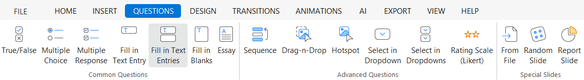

Go to the Question tab, choose 1 among 13 questions types.
Immediately, the question will appear as the top layer on the video.
