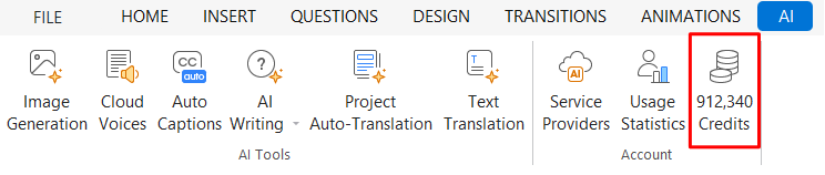

You can also keep track of your usage at any time. Just open the AI tab to view your credit statistics and remaining balance.

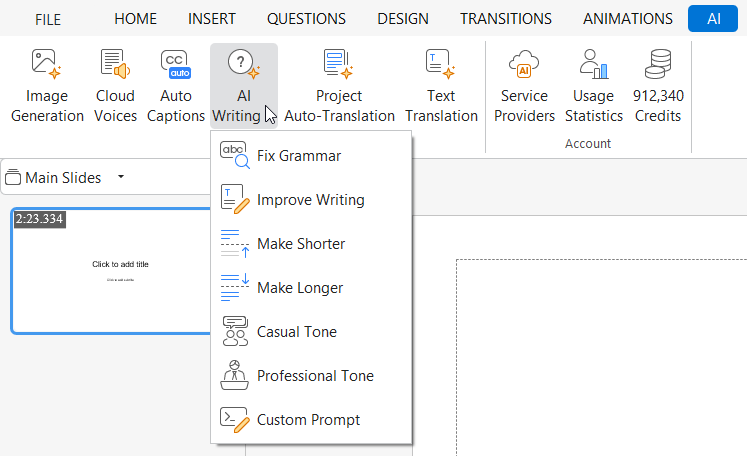

Step 2: Navigate to the AI tab and then click on AI Writing. A dropdown menu with several options will appear:
Step 3: Select from several pre-built options to instantly improve your writing:
- Fix Grammar: Corrects grammar, punctuation, and sentence structure with a single click. Ideal for a quick proofread.
- Improve Writing: Enhances the overall clarity, tone, and readability of your content.
- Make Shorter: Condenses lengthy text into shorter, more concise versions, which is great for slides with limited space.
- Make Longer: Expands brief text into more detailed explanations while preserving the original context.
- Casual Tone: Rewrites your content in a friendly, conversational tone.
- Professional Tone: Adjusts your text to be more formal and polished, perfect for business or academic materials
- Custom Prompt: Enter your instructions to customize how the AI rewrites or generates content based on your needs.

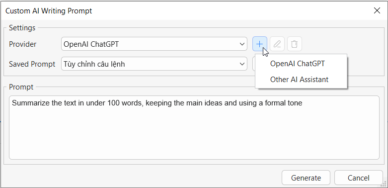

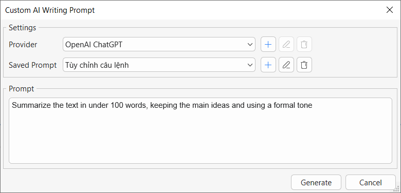

For more control, you can use the Custom Prompt option. This feature lets you provide specific instructions to the AI for a personalized result. When you select Custom Prompt, a new dialog box will appear:
Here, you can:
- Use the default provider: The default provider is OpenAI ChatGPT.

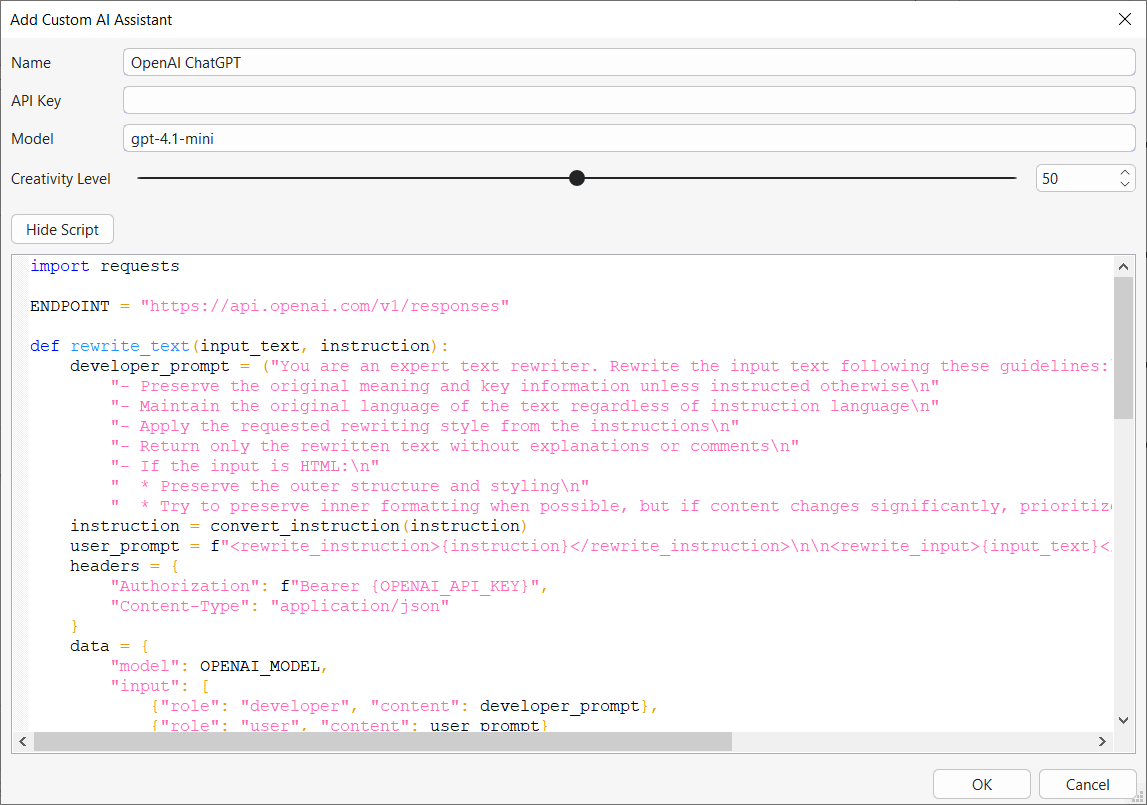

- Add a custom provider: Click the Add Custom AI Assistant icon. You can either use the integrated OpenAI ChatGPT or add Other AI Assistant.
- OpenAI ChatGPT: A dialog appears and gives you information about Name and Model. You can also adjust the Creativity Level using the slider, or Edit Script if needed.

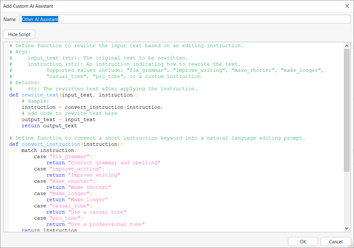

- Other AI Assistant: This option allows you to integrate other services by editing the provider’s script.

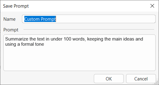

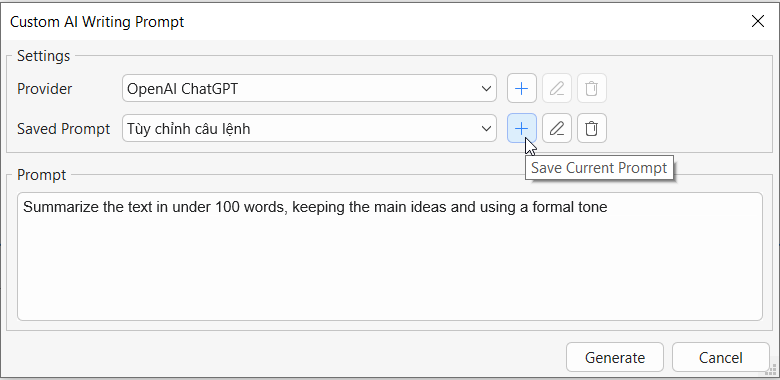

You can save your prompt to reuse later. Click on the Save Current Prompt icon .
The Save Prompt dialog also lets you manage your prompts for future use:
- Here, you can name your prompt, adjust the prompt > and click OK to save or Cancel to cancel the dialog.
- Edit a Saved Prompt: Use the Edit icon to modify a saved prompt.
- Delete a Saved Prompt: Click the Remove icon to delete a prompt you no longer need. A confirmation dialog will appear.
