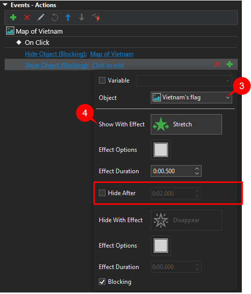

The next step is adding the Show/Hide Object action to each side to flip the other side when learners click on it. For that to happen, on the front side, do the following:

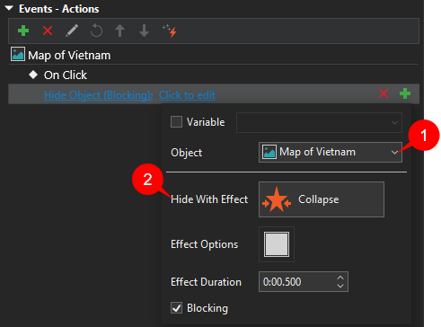

- Insert On Click event.
- Add Hide Object action > hide the front side (1) > choose the Collapse hiding effect (2).
- Add Show Object action > show the back side (3) > choose the Stretch showing effect (4). Remember to deselect the Hide After check box so that the image will not disappear after being shown for a period of time.
Note that to make this Show Object action work properly, you should hide the back side as soon as the project starts. To get it done, you can right-click it in the Timeline or on the Canvas, then select Initially Hidden.

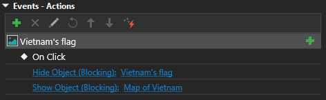

Similarly, you can add the On Click event to the back side. Then add the Hide Object action to hide itself and the Show Object action to show the front side again. All settings should be the same as on the front side.

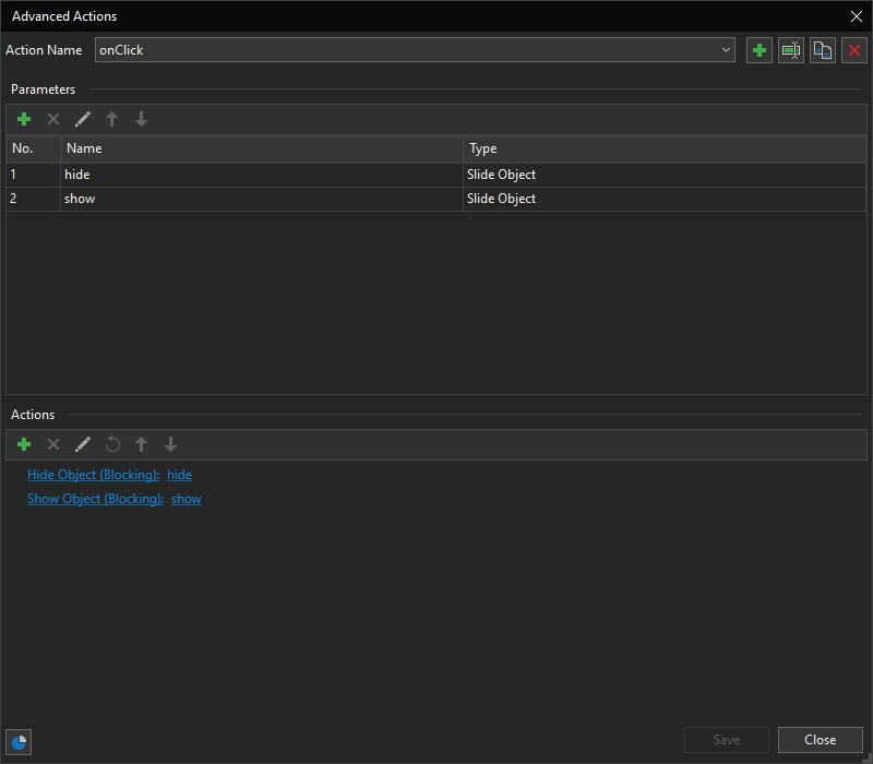

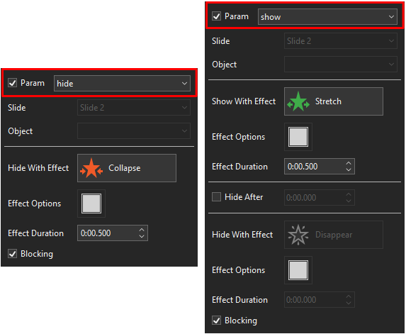

To create a new advanced action, click Advanced Actions in the Questions tab or the Properties pane. I’m going to add values for 3 sections, namely, Action Name, Parameters, and Actions in the Advanced Actions dialog in turn:
- Give a name for the advanced action, such as “onClick”.
- Add two parameters with their corresponding types. For example, I create two parameters and name them “show” and “hide”, and select the Slide Object type for each of them. This type can be used for the Show/Hide Object action that will be mentioned in detail in the Actions section right below.
- Add 2 actions using parameters created above. Particularly, add the Hide/Show Object action and apply for parameter “hide”/”show”, accordingly.
After all, click Save and Close to save the advanced action and close the dialog.

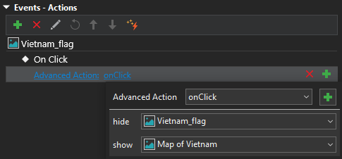

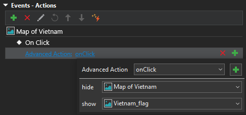

To do that, on each front side, navigate to the Properties pane > Interactivity tab > Events – Actions. Here, you need to add On Click event and apply the advanced action “onClick” as the image below:
Then, reference the parameter “hide” to hide the front side. And reference the parameter “show” to show its corresponding back side.
Similarly, on each back side, you can inversely change the parameter to hide the back side and show its front side again.
For other front sides or back sides, you just need to copy and paste the action and change the parameters.
